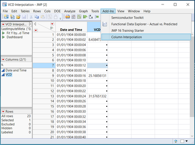

The Column Interpolation Add-In will:

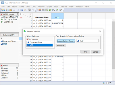

  • Bring up a dialog for column selection.

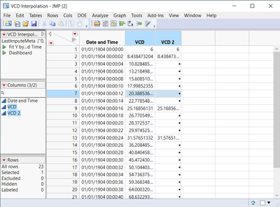

  • The selected column will be copied.
  • The original column will have it's missing values imputed by linear interpolation.

Why doesn't it work when I use it, it does not interpolate, but just copies a new column, and the missing values are not filled.
In addition, it would be great if more interpolation methods (such as polynomial interpolation, spline interpolation, etc.) can be implemented.
cmountacrc
@wwh The new column appears to be a copy and the interpolated data is in the original column.
