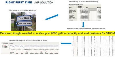

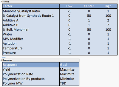

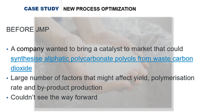

This is the use case:
  • Session Exercise:
    • Create a screening design with the custom designer leaving the default settings
    • Analyze the results using the "Model" Script as well as Graph Builder to understand what factors seem to have an impact on yield. (using "Chapter 2 results.jmp" attached in this post)
  • Homework Exercise:
    • Create the same screening design in the custom designer as in the exercise, but with minimum runs as well as with more runs. What can you say about the Power of the design? What design would you choose when you have to decide?
    • Read through What is correlation? and What is regression? in the statistical knowledge portal to understand what the p-value represent and what a linear model is.
    • In preparation of the next session about Screening and Definitve Screening Designs read through this blog post  by Bradley Jones, one of the inventors (next to Chris Nachtheim) of Definitive Screening Designs.

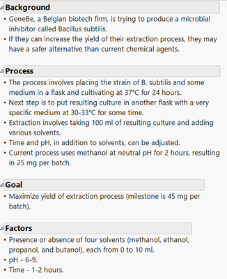

We discuss this use case:
These are the factors considered:
  • Session Exercise:
    • Create a Definitive Screening Design using the attached factors table ("DSD Factors.jmp") and the default settings
    • Analyze the results in the attached JMP data table "DSD Results.jmp" using the "Fit Definitive Screening" Script
    • Create different traditional Screening Designs with about the same number of runs and compare these to the DSD approach
    • Review proper use of Definitve Screening Designs by reading through this blog post  by Bradley Jones, one of the inventors (next to Chris Nachtheim) of Definitive Screening Designs.
