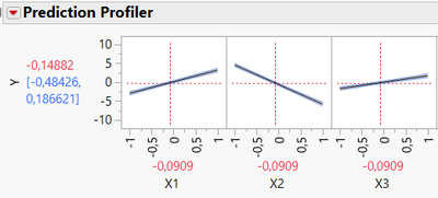

Victor_G
Re: which factor type shold be choosen for custom design
Hi @yukko,
The type of variable will not create differences in the design if you have 2 levels.
If you want 3 levels, choosing discrete numeric factors help setting the intermediate level at any chosen value in the factor's range, whereas continuous numeric factors require setting quadratic terms in the model (and/or centre points) to include a third level in the design (that will be automatically a middle point in the range of the factor).
The big difference of treating numeric factor as discrete or continuous is about the interpolation, that means the possibility to predict the response(s) continuously at any given value between the levels used for continuous factor, depending on the regression model and terms used in this model.
Profiler with X1 as discrete numeric and 2 levels (modeling done with the 2 levels but predictions can only be done by specifying one of the two levels studied):
Profiler with X1 as continuous numeric with 2 levels (modeling done with the 2 levels but predictions can be done on the whole range of X1, from -1 to 1):
