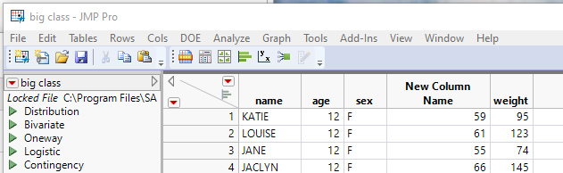

with the data table having the following names after the script was run
Jim
Jim
