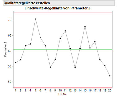

Hello everyone,
The control charts I use look like this (I use the german language):
But I like to keep the titles short so "Einzelwerte-Regelkarte von Parameter 2" I changed into "Parameter 2".
Now when I save this control chart to my data table and open it again it comes up as before with that full title.
Does anyone have an idea of how to prevent that?
The hing is that I like to include more control chart into a dashboard, but then the dashboard will also open with full standard title and that makes it difficult to setup the right size of each control chart in the dashboard.
Then I need to resize each control chart within the dashboard and of course shorten the titles before.
As software I am using JMP 16.0, maybe 16.1 is better but the IT has not yet installed it on my PC.
Thanks for your help
Jan

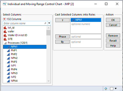

I quickly tested this with Semiconductor Capability example dataset. It seems like there is an issue when you use the exactly same name as the column has (at least in JMP15.2.1).
Modify title to NPN1
Script saved to data table:
Control Chart Builder(
	Show Control Panel(0),
	Variables(Y(:NPN1)),
	Chart(Position(1)),
	SendToReport(
		Dispatch({}, "graph display 1 title", TextEditBox, {Set Text("NPN1")})
Result of table script:
Now lets modify the title by adding space before the NPN1 and save the script to data table:
	Chart(Position(1)),
	SendToReport(
		Dispatch({}, "graph display 1 title", TextEditBox, {Set Text(" NPN1")})
And running the script:
No sure why this happens, but maybe modifying the titles a bit will help at least until this is changed. Maybe add something that will directly indicate what type of control chart you have like "IMR of Parameter 2"
-Jarmo

jthi
Re: titles of control charts change to standard after saving and reopening
	Chart(Position(1)),
	SendToReport(
	Chart(Position(1)),
	SendToReport(
-Jarmo
