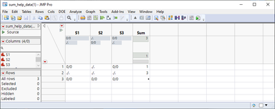

I have attached a small data table to my post. It has 3 rows and 3 cols with a header:
S1    S2    S3
0/0   ./.     0/0
0/0  0/0    0/0
The script doesn't work in this sample table
Column sum Formula Interrupted
argument is wrong type at row 1 in access or evaluation of 'Contains' , Bad Argument( Column( i )[] ), Contains/*###*/(Column( i )[], ".")
Formula evaluation errors have been ignored

The original data table you attached wasn't like that as it has 4 columns (you cannot ignore Sum column)
Depending on your data, this is how I would do this if I were to use a Formula (most likely I would avoid that and just use a pure script solution)
