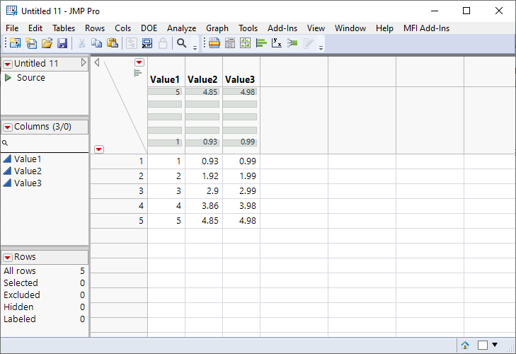

jthi
Re: How to create a data table of 3 columns per row from numeric string

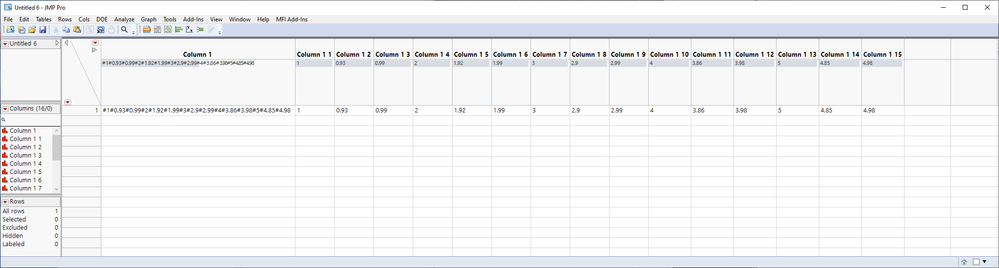

Use Text To Columns to get this

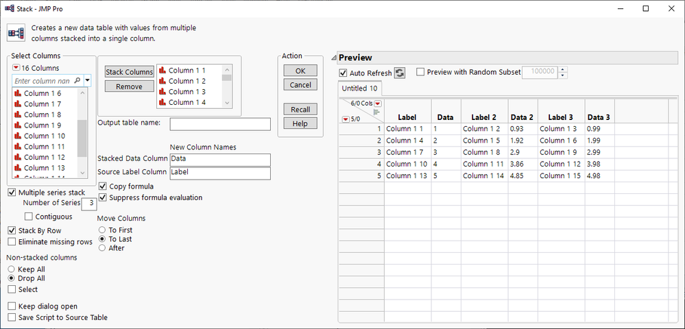

Then stack your data with multiple series stack
and finally remove extra columns, rename column headers and fix column data/modelling types
JMP created script is a good starting point for the final JSL
// Text to columns
Data Table("Untitled 6") << Text to Columns(columns(:Column 1), Delimiters("#"));
// Stack data table
// → Data Table("Untitled 11")
Data Table("Untitled 6") << Stack(
	columns(
		:Column 1 1, :Column 1 2, :Column 1 3, :Column 1 4, :Column 1 5, :Column 1 6,
		:Column 1 7, :Column 1 8, :Column 1 9, :Column 1 10, :Column 1 11,
		:Column 1 12, :Column 1 13, :Column 1 14, :Column 1 15
	Source Label Column("Label"),
	Stacked Data Column("Data"),
	Drop All Other Columns(1),
	Number of Series(3),
	Output Table("Untitled 11.jmp")
// Delete columns
Data Table("Untitled 11") << Delete Columns(:Label, :Label 2, :Label 3);
// Recode column names
Local({dt = Data Table("Untitled 11"), names},
	names = Recode(
		dt << Get Column Names(String),
		{Map Value(
			_rcOrig,
			{"Data", "Value1", "Data 2", "Value2", "Data 3", "Value3"},
			Unmatched(_rcNow)
	For Each({name, i}, names, Column(dt, i) << Set Name(name));
// Standardize column attributes
Local({old dt = Current Data Table()},
	Current Data Table(Data Table("Untitled 11"));
	For Each({col, index}, {:Value1, :Value2, :Value3},
		col << Data Type(Numeric, Format("Best", 12)) <<
		Set Modeling Type("Continuous")
	Current Data Table(old dt);
-Jarmo

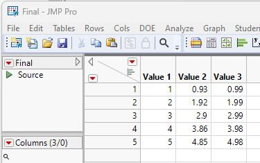

txnelson
Here is one approach
Names Default To Here( 1 );
theString = "#1#0.93#0.99#2#1.92#1.99#3#2.9#2.99#4#3.86#3.98#5#4.85#4.98";
dt = New Table( "Start",
	add rows( 1 ),
	New Column( "string", character, set each value( theString ) )
dt << Text To Columns( delimiter( "#" ), columns( :string ) );
dt << delete columns( :string );
colNames = dt << get column names( string );
For Each( {col}, colNames,
	Column( dt, col ) << Data Type( Numeric, Format( "Best", 12 ) ) <<
	Set Modeling Type( "Continuous" )
dt << Stack(
	columns( colNames ),
	Source Label Column( "Label" ),
	Stacked Data Column( "Value" ),
	Number of Series( 3 ),
	Output Table( "Final" )
dtFinal = Current Data Table();
dtFinal << delete columns( {:Label, :Label2, :Label3} );
dtFinal:value << set name( "Value 1" );
close( dt, nosave);
Jim
