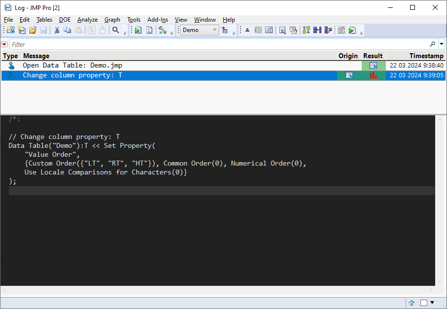

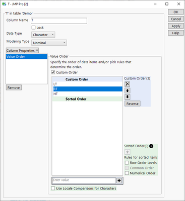

jthi
Re: How to use Set Property() to make a custerm order for a column?
Do it interactively in JMP and get the script from enhanced log OR  by using Copy Column Properties
Data Table("Demo"):T << Set Property(
	"Value Order",
	{Custom Order({"LT", "RT", "HT"}), Common Order(0), Numerical Order(0),
	Use Locale Comparisons for Characters(0)}
Copy Column / Copy Column properties scripts usually require a bit modification (this is from Copy Column Properties)
Add Column Properties(
	Set Property(
		"Value Order",
-Jarmo
