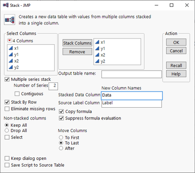

pmroz
Re: stack columns
Here's how you would fill out the Stack dialog:
