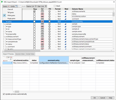

Doesn't Wide Guess get you quite far?
-Jarmo

@jthi Thanks for the response and sorry for the late reply - Welp. Wide guess is definitely the way to go. I thought I had clicked that, but I guess I misclicked or something. Thanks for pointing it out.

After you get the data to JMP table (Wide format most likely works) then you start figuring out different methods JMP can further clean/modify the data. I don't think you can directly do everything in XML Import Wizard (Parse XML most likely could do it, but it is fairly complicated to use, in my opinion).
