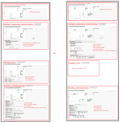

scripting t-test: picking favorite features from several ANOVA/t-tests; 2-sample vs 3+-sample?
So curious how to make this happen. I've got a long list of charts, some with 2 chambers, some with 3+ chambers. I'd like to script a t-test kind of script to standardize the output. Any advice? There's parts and pieces I like from several different options.
Goal:
- output a chart w/ student's t Circle Plots
- output a 'summary report' with sample count, mean, stDev
- output a p-value for the whole chart (Means/Anova/Pooled t")
- (nice to have: pair-wise p-value and labeling, but not that important).
I've noticed that the options and outputs are quite different if I have a 2-sample chart vs a 3+sample chart.
Any advice how to script this?

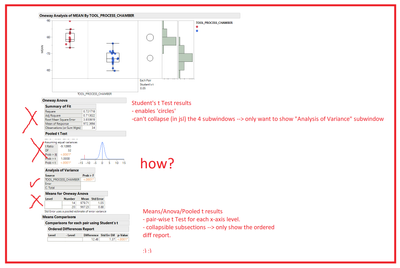

So I setup some JSL and edited as much as I can figure, but still hitting a roadblock. I can't seem to collapse/hide Student t Test subwindows.
Is there a BKM for simply outputting the YbyX chart, circles, histogram on upper level and then "Analysis of Variance, Summary, and Ordered Difference Report on lower level?

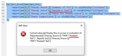

Thank you. This is kinda working. One problem is that a graph with 3+ chambers does not have a Pooled t Test section, then it errors out and stops.
How to move past to next row while still staying in its i iteration?
txnelson
Re: scripting t-test: picking favorite features from several ANOVA/t-tests; 2-sample vs 3+-sample?
If you have an easy way to check the number of levels, you can use an IF() to check and bypass the statement.  Or, you can use a TRY() function to keep it from ending when the statement fails
try(report(ow[i])["Oneway Anova"]["Pooled t Test"] << visibility("Collapse"));
