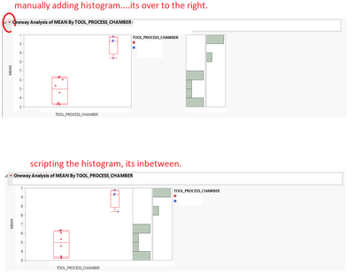

So I'm trying to script a standard display, but the script output is *different8 than just selecting the dropdown. Anyway to control location of added items?
example:

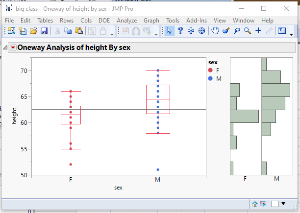

Forcing the order by specifying specific JSL commands your desired outcome can be obtained.
names default to here(1);
dt=open("$sample_data/big class.jmp");
//dt<<color by column(:sex);
ow = Oneway(
	Y( :height ),
	X( :sex ),
	Box Plots( 1 ));
report(ow)[FrameBox(1)] << Row Legend("sex");
ow << histograms(1);
Jim

aliegner1
Level IV
Re: control location of display charts? histogram on Fit Y by X
@txnelson @Mark_Bailey
thank you. this works great....except when I journal the results. it automatically moves the legend over to the right.
Any thoughts?

This works for me
ow = Oneway(
	Y( :height ),
	X( :sex ),
	Box Plots( 1 ));
report(ow)<<journal;
Jim
The histogram is added to the current display. Enable it after adding the row legend if you want it to the far right. Add the histogram before the row legend if you want it in between.
