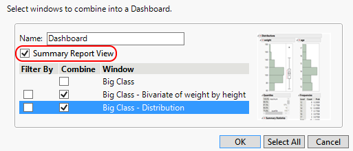

Re: screen size
JMP Reports like Graph Builder and Bubble Plot stretch with window size by default, and combined with Splitter Boxes in a dashboard give you a lot of flexibility in size and layout.  Other JMP reports may not stretch by default, and require customization to create a stretchable dashboard.
One built-in feature for dashboard stretching is Summary View.  You can opt-in to the Summary View when creating a dashboard using Combine Windows:
In a running dashboard, you can also toggle Summary View on or off for all reports (from the top-level red-triangle) or for any individual report (from the report red-triangle):
Summary View makes graphs stretchable, but also hides most other information, such as tables.  Stretching works best when there is little else in the window, because otherwise the tables and other display information will cause the graph to shrink to a size too small to be very useful.

Suggestions 1 (Collapse) and 4 (Stretchable) are essentially what Summary View is doing for you with a rule-based approach.  With JSL and interactive customization you can more precisely create the type of stretchable dashboard that you are looking for.
Hope that helps!
