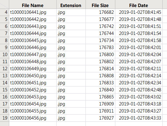

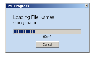

50K/minute for this configuration of a network50K/minute for this configuration of a network
Columns include filter valuesColumns include filter values
