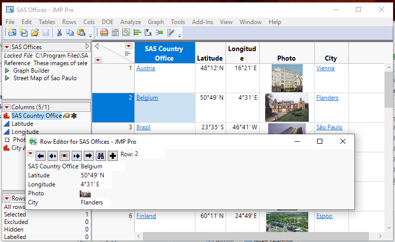

Hi,
when we use row editor we have the information on all columns for a line.
Is it possible to configure the row editor only on certain columns and have the photo displayed if we have a column with photos ?
best regards

txnelson
Re: row editor
The Row Editor will display photos
but it always displays all columns.  You could write a simple script that would handle your request.I also suggest that you add your request to the JMP Wish List, so it can be reviewed for possible addition to a future release.

Françoise
Level VI
Re: row editor
hi,
thanks for your answer Jim.
but, the image is too small as in your copy screen.
and how to access to the script of the editor?
I would like to change the size of the image and make a selection for the columns.

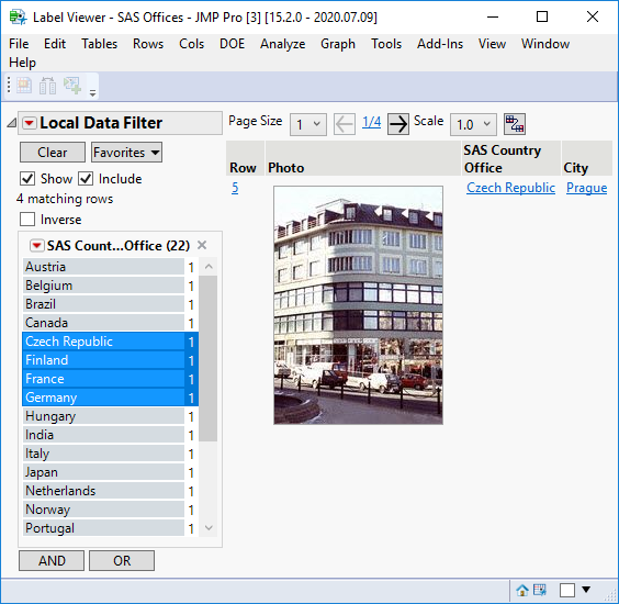

nascif_jmp
Level VI
Re: row editor
Hi @Françoise,
This is not exactly what you are asking about but is close: the LabelViewer Addin will show only the labeled columns for a given row, and has support for controlling the size of the images it displays: Label Viewer: exploring multiple images and text associated with a single visual element using Hover...
I designed it to be launched from a graph hover label, but since it is all based in JSL, it could probably be adapted to be launched directly from the table. It contains a Local Data Filter which you can use to control the scope of the rows displayed. Give it a try and let me know how it goes.

nascif_jmp
Level VI
Re: row editor
@Françoise Fair enough. Please check the Addin page again. I just attached an adapter file named "LabelViewer_dt.jsl". Once you have the Addin installed, you just have to open e execute that script and it will open the LabelViewer window for the current window. It assumes that the data table has at least one labeled column. If you want to see images, their columns have to be labeled also. Here is what it displays for SAS Office:
You can control what is displayed using the filter, number of rows displayed per page, size of the images, and layout (horizontal vs vertical).
