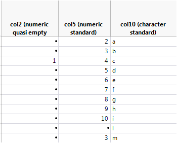

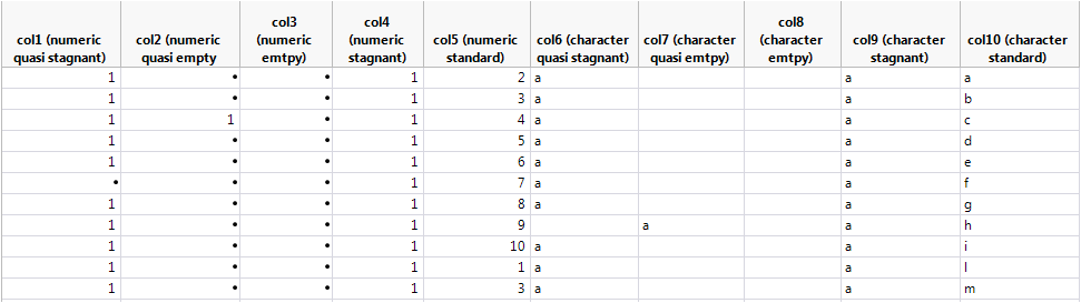

FR60
Level IV
Re: remove almost empty categorical columns
Hi
I tried yor script on the second table below and the result is here.
As you can see it was able to remove almost all desired columns but second one (col2) not. How I can do to remove it too?
Thanks  Felice
msharp
Super User (Alumni)
Just combine the strategies.  Something like:
Names Default To Here( 1 );
dt = Current Data Table();
percent = 90;
delcols = {};
numRows = nrows(dt);
for(i=1; maxi=NCols(dt), i<=maxi, i++,
	if(nrows(loc(aslist(column(dt,i)<<getasmatrix),mode(column(dt,i)<<getasmatrix))) > numRows * percent/100,
		insert into(delcols, i);
		if(Col N Missing(column(dt,i)) > numRows * percent/100,
if(nitems(delcols) > 0, dt << delete columns(delcols));
