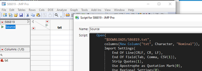

jthi
Re: read and save a txt file from a subdirectory of a ZIP file
I didn't (yet) check where your script goes wrong, but there is a version which should save the txt file (requires JMP16+ due to For Each() and Filter Each())
Names Default To Here(1);
file_of_interest = "mytxtfile.txt";
zip_path = "$DOWNLOADS\test.zip";
save_path = "$DOWNLOADS\586819.txt";
za = Open(zip_path, "zip");
members_in_zip = za << dir;
// take only .txt files
file_paths_of_interest = Filter Each({members}, members_in_zip,
	Ends With(members, file_of_interest);
If(N Items(file_paths_of_interest) == 0,
	Throw("Not found");
// Assume that only one of those files exist
file_path_of_interest = file_paths_of_interest[1];
data = za << read(file_path_of_interest, Format("string"));
Save Text File(save_path, data);
//Open(save_path);
-Jarmo
