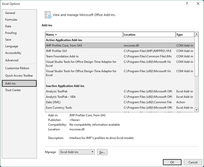

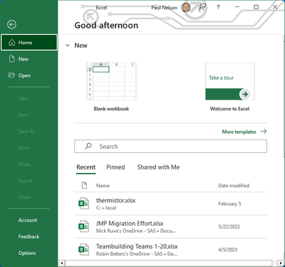

There are 2 key JMP COM objects that get loaded into Excel for connection between JMP and Excel.  There is a JMP GUI component, and the JMP Core component.  JMP Core is what loads JMP's COM object model so that Excel can transfer Data to JMP and the entry point for JMP to call cell formulas in Excel to do run the profiler.  You should check that Excel has not disabled the JMP COM add-in.  At the bottom of the file menu is the 'Options' choice.
Selecting 'Options' brings up a dialog, select 'Add-ins' from the column on the left.
You should see both JMP Profiler Core, and JMP Profiler GUI add-ins in the list of add-ins.  If you do not see them, go down the bottom of the window for the Manage drop-down menu and select COM Add-ins, then click the Go button.
Verify that both the JMP Profiler Core and JMP Profiler GUI add-ins are selected.  Your dialog should look like this.
If the JMP core and GUI entries are not checked, check on the boxes and select OK
