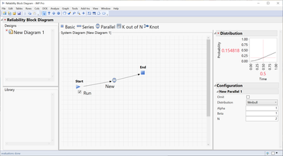

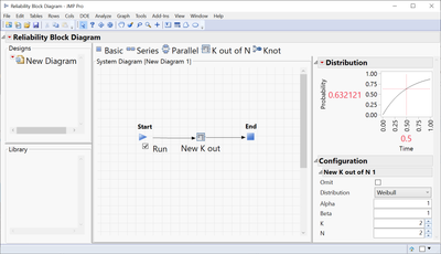

Alternatively, if you have JMP Pro, you can use the Reliability Block Diagram platform to easily see the distribution of failure time for this "K out of N" system.

Actually, I think is a parallel system design, not "K out of N"
