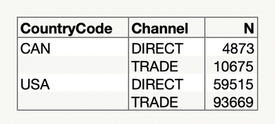

Hi, I'm in tabulate and has the below table:
Is there a way i can make the channel into one cell using existing function, not script?  like:

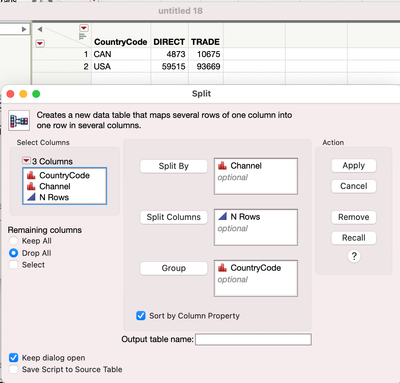

Thank you Jim! I'm stuck in the split step you mentioned- how did we get the direct trade in the right place to concatenate while having the numbers in the cells?

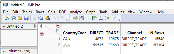

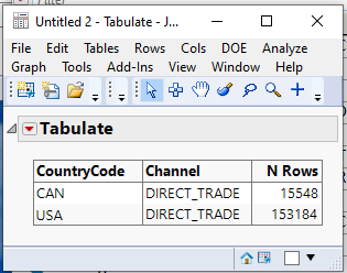

  4. Now use the Tabulate platform to create the Display output you want                                                  txnelson_1-1634674860467.png
