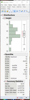

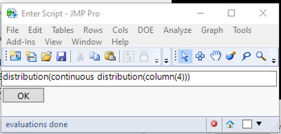

As shown below, when the user inputs the desired script into the text box(ex. Distribution( Continuous Distribution( Column( :X) ) );)
and then executes the button box, how can the corresponding script be executed as analysis? Thanks for letting us know!
I want the script to be executed as analysis when the user inputs the desired script into the text box and then executes the button box as shown below.
How can I execute the text entered in the text box immediately with a button click?
Though I stored the desired script as a variable using get text() and write(), it is not executed as an analysis.
I would really appreciate it if you could tell me how to solve it.

Use the Eval(Parse()) combination of functions to execute a text string of JSL
Names Default To Here( 1 );
New Window( "Enter Script",
	V List Box(
		tb = Text Edit Box( "", <<set width( 400 ), <<set script( theScript = tb << get text ) ),
		OKButton = Button Box( "OK", Eval( Parse( theScript ) ) )
Jim

It works!
Thanks all for your kindly help :)
