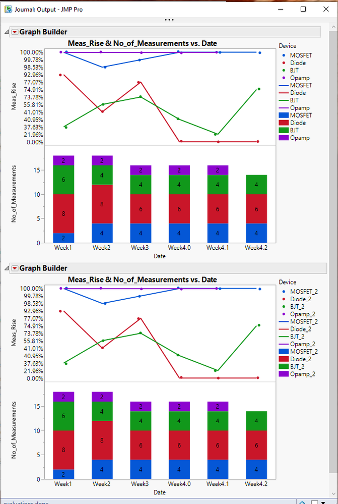

Here is one approach to solve your problem.  It loops through your data, 4 devices at a time, generating a chart and then moving the graph to a JMP Journal window, and then moving on to the next 4 devices.  I have attached a sample data table that I used for the development.  Please note, that the first 4 devices and the second 4 devices generate the same look of the graph, since all of the data are the same, except for the device names.
The script is not real robust.  It assumes that there are multiples of 4 devices, all graphs are to be output in a single column down the output page, etc.  I am providing the JSL as a starting place for a possible solution, not the final, robust piece of code it probably should be

I'm using JMP 12 and summarize function sorts column values alphabetically.
Is there a clean way to get column values w/o aplhabetizing?I checked other posts but could not find a good way to do this.
