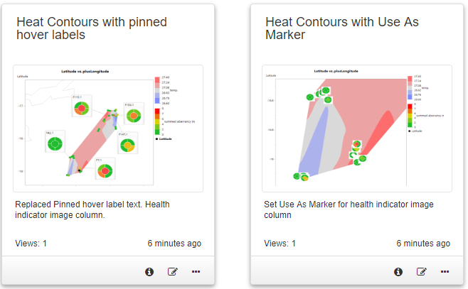

Graph Builder doesn't provide a way to place bar charts or pie charts at specific locations on a map. You can get around it by:
  1.  Creating a table from your Graph Builder graph where you use sample number in the map role (built using bars or the custom map shapes. This creates a table with sample number column and a column of images for each sample.
  2.  Copy the image column from the generated table back to the unstacked data table( make sure that the image column matches the order of the sample number. **
  3. a. Label the image column OR b. Set 'Use as Marker' for the image column.
  4. Using the unstacked data table, create a Contour Map in Graph Builder using salinity or temp column as the color Role.
  5. Add a points element.  Optionally using another color role.
  6. If you follow step 3.a, the images will appear in hover labels. You can pin some hover labels and Replace Text to remove any unwanted hover label text.
  7. if you follow step 3 b, all markers will be shown with the image from the image column. This can cause a cluttered display which you can resolve by zooming in or by deleting images that are overlapping.
** I found they were not in the same order, and had to sort before copying the image column. In hindsight, I realized I could have used a join or virtual join to get the images on the correct rows. I wish I would have read this first: https://community.jmp.com/t5/JSL-Cookbook/Geographic-Maps-with-Graphs-as-Markers/ta-p/53782.
I published both 3.a and 3.b here:
https://public.jmp.com/packages/Heat-contour-with-image-annotations/js-p/5d64597acf28b80f980812ba
About the method I used to draw the bars. I didn't use custom maps, I used the custom graphics script to calculate the length of the bars and to position them above each point.
When it comes to streamlining, JSL is often the best choice.
~John

 I'm joining this discussion quite late, but I am trying to create a very similar type of visualization. I'm particularly interested in the "3.b" solution, as I want to display pie charts on a grid across Europe (the label style is not readable at all in this scenario).
Point is that when I use graphs as marker, the background is white which doesn't look so good on the maps : they tend to overlap on the corner.
Although I can make the white area smaller by adjusting the pie chart size, the white background remains visible. Is there a way to make this background transparent or remove it entirely in JMP 17 ?
Johanna
Re: pie graphs+heat maps
Hi @johanna_younous ,
Welcome to the conversation.
When I first joined this conversation, I had white backgrounds in my graphs too.
By the time I did the presentation I mentioned above, I figured out how to make the background transparent.
I used the following JSL script to make the white pixels transparent in my table of images where the name of the column of graph images was "Graph".
dt=CurrentDataTable();
For Each Row(
	{r, g, b} = dt:Graph[] << getpixels( "rgb" );
	a = !AND(r == g, g == b);
	dt:Graph[] << setpixels( "rgba", {r, g, b, a} );
This also makes gray pixels transparent where the red, green, and blue color components are all the same. I had some gray in the background too.
I hope this works for you.
~John
