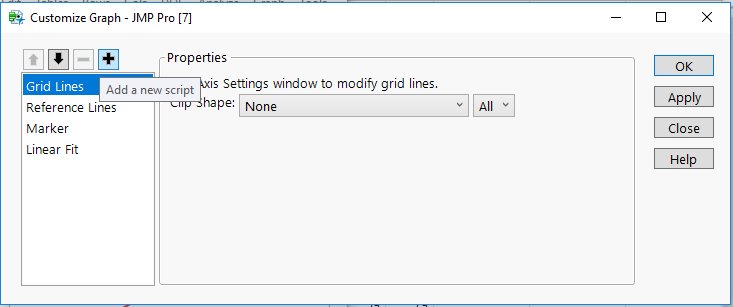

Overlaying on a map would require a different mechanism, like using the script in the Customize dialog:customizeDialog.png
There are some sample scripts provided:
You can find information on the Customize feature here:
https://www.jmp.com/support/help/14-2/customize-graphical-elements.shtml

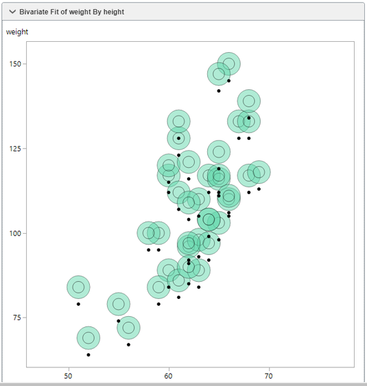

Here's a small example using circles:
With some effort and study of the graphics functions available in JSL (see: https://www.jmp.com/support/help/14-2/graphics-functions.shtml#2616158 ), more complex, color coded shapes are possible.

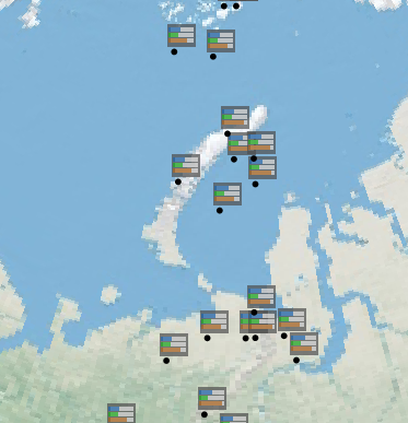

I published a better custom graphics script example annotating three variables per point on a map.
It's on JMP Public. Just click on the following following link:
https://public.jmp.com/packages/5d605bce3560ce0d2cafd48b
I used simple bars(thick lines) to represent three contrived cell values per point. Pie shapes would take a bit more work, but I wanted to offer this up as a proof of concept. The JSL script can be seen and downloaded from the post details on JMP Public.
