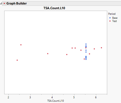

This is a dot plot of your data, colored by Period. All Base observations have the same value.

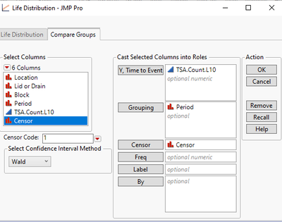

Besides GenReg, two other platforms may help you study data with censored observations with a grouping variables: Life Distribution with grouping (first screenshot above), and Fit Life by X. The two might be more appropriate, if all you need is to compare groups of observations.

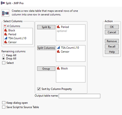

First I split the data to form a new one:
And here is the result:

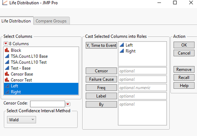

For individual rows, if Left is Missing, Right is not, that is a Left censored observation. If both Left and Right are not missing, and they equal, that is an exact observation. Use the Life Distribution as follows:

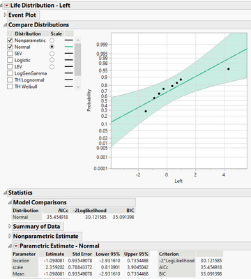

Then fit a distribution, and Normal looks good to me.
Now the question becomes whether the location parameter estimate is significant different from zero. If the answer is yes, then the two groups are significantly different. No, otherwise. In this example, assuming I guessed corrected that the censoring in the data means right censoring, then two groups look no significant different. If I guessed incorrectly, the censoring type of the differences would had been right censoring. Then change the steps accordingly.
