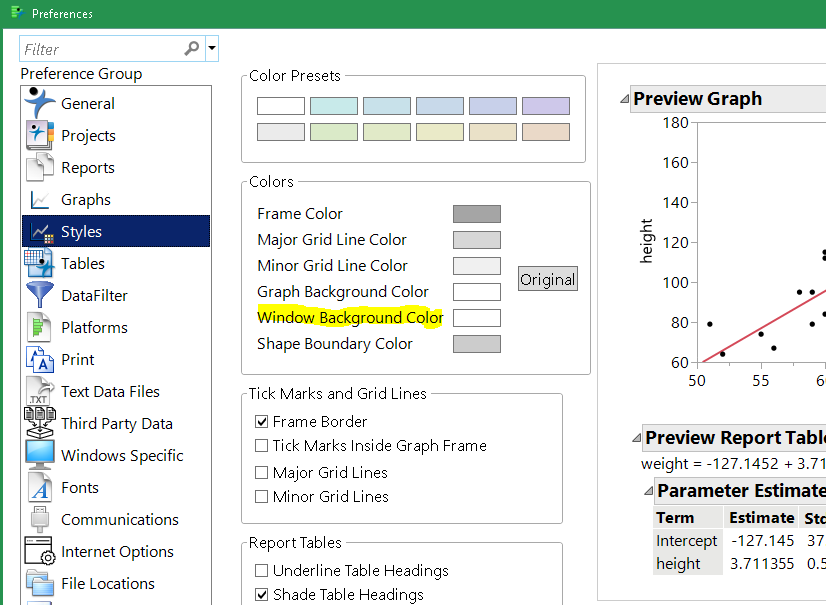

I can't reproduce the issue either. I'm imagining dark mode might be involved, somewhere.
I tried changing my background color in JMP, but it seems ignored by JMP's EPS writer (good! Orange is a terrible background color, but not as bad as black! I keep my background set to white.)
Control-K opens the pref window.Control-K opens the pref window.

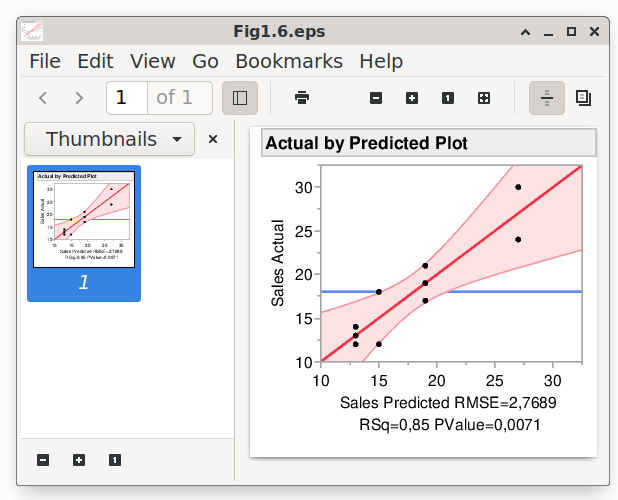

The black area may actually be transparent (though my only rendering tool says it is white). JMP probably draws a rectangle of the Graph Background Color inside the frame. A .zip of the .eps is attached; for me it looks like this
Linux EPS viewer.Linux EPS viewer.
