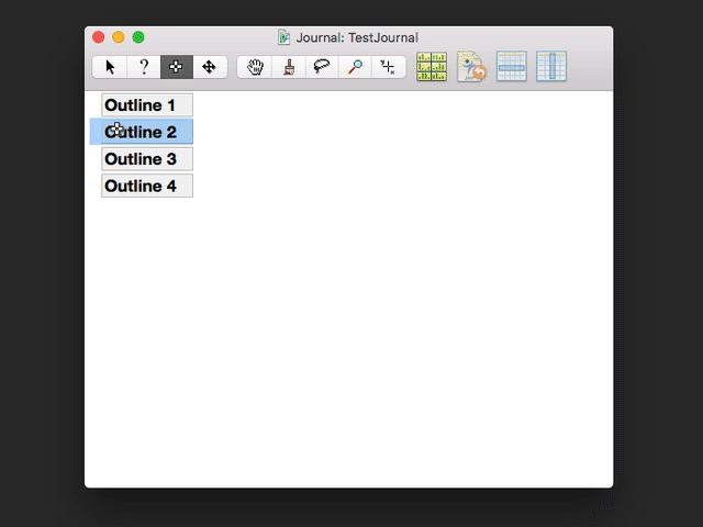

When working with a journal, @brady_brady's Journal Text Sledgehammer is a must-have. I use it every time I work with journals. Makes mass-editing things like font sizes and wrapping easy, and also has a button for opening and closing all outlines.
Also, here is the selection tool in action:

Re: organizing a journal
Use the Selection tool from the Toolbar or Tools Menu.
Then click on the outline node you want to move to select it. Then drag it to the new location.
hello,
It' OK. thanks!
