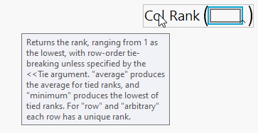

I found the option
rank(:col1, << tie(mode))
but I did not find a mode which produces number 1, 2,3 ... N

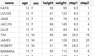

I thought that one can get there by using rank twice:
New Column( "step1",Formula( Col Rank( :sex, <<tie( "average" ) ) ));
New Column( "step2",Formula( Col Rank( :step1 ) ));
But step2 knows some secrets about column step1 which the user can't see:
