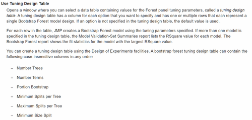

Hi all,
I have a case where I want to apply a Bootstrap Forest approach in combination with a tuning design table. While following the instructions in JMP-Help I ran into the problem that only two out of the six described hyper parameters in the tuning table made it into the nunmbers of models build according to the run number of the tuning table.
Was this issue identified by someone else, too?
I already discussed this with @Jonas_Rinne  and we didn't came up with a satisfying solution. Or is it a bug?

There seems to be some inconsistency between the help page and the scripting index. Here is what the help page suggests as column names for the different hyperparameters in the tuning table:
In the scripting index the columns are named slightly different (Split/Splits):
Does someone had the same issue before? Did we used the wrong column names or is it something else? The first two hyperparameters work just fine.
