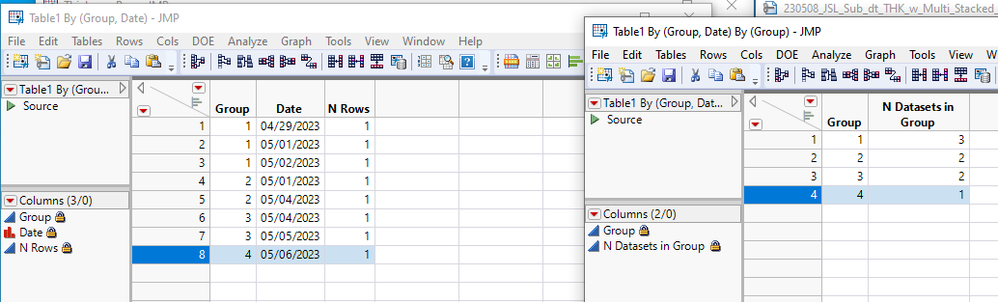

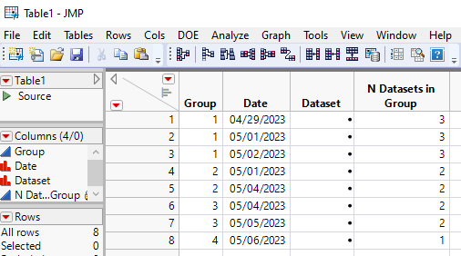

Hi all,
How can I write an integer value counter to increment unique values in column B within group A, to do this?
Here is what I have tried so far:
dt_Table1 = Data Table("Table1");
dt_Table1 << New Column("Dataset", Numeric, "Nominal", Set Selected);
Sum1 = dt_Table1 << Summary(Group(:Group, :Date));
Sum2 = Sum1 << Summary(Group(:Group));
:N Rows << Set Name("N Datasets in Group");

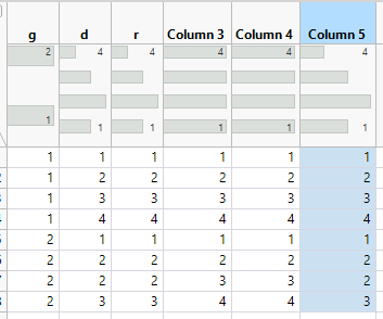

You should be able to do this with some combination of Col Rank(), Col Cumulative Sum, Col Min() and so on functions. Based on your example, Col Rank() or Col Cumulative Sum(1, <byvars>) should be enough (there are no duplicate dates in any of the groups).
Column 3 is using Col Rank and Column 4 Col Cumulative Sum and Column 5 one option of a bit more complicated formula

Thanks Jarmo!  Your way is definitely cleaner.  I don't totally follow the logic, but I see it works!

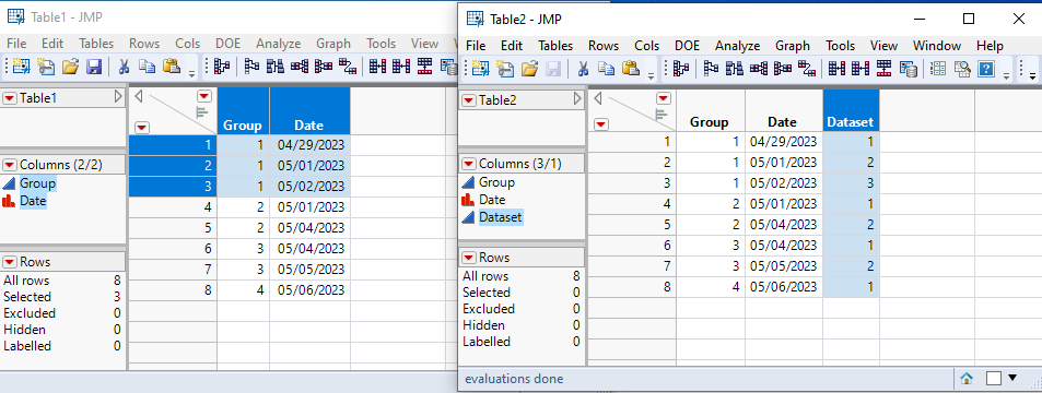

Note: I found another way, that also used Col Cumulative Sum().  Slower than yours.  Multiple sub-tables and a join...
Summary1 = Table1  << Summary(Group(:Group, :Date));
Summary2 = Summary1 << Summary(Group(:Group, :Date));
Summary2 << New Column( "Dataset",
Numeric,
"Nominal",
Set Selected
:Dataset << Formula(Col Cumulative Sum( :N Rows, :Group ) );
