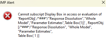

Thanks Ben.
I am getting this error:

Re: need to extract slope and intercept from parameter estimates table in a linear least squares model fit and save to a file
The same code works for me
dt=Open("$SAMPLE_DATA/Tablet Production.jmp");
obj = Fit model(Y( :Dissolution ),Effects( :Mill Time),Personality( "Standard Least Squares" ),Emphasis( "Effect Leverage" ),Run(:Dissolution )) ;
rpt=obj<<report;
rpt["Response Dissolution", "Whole Model", "Parameter Estimates", Table Box( 1 )] << Make Into Data Table;
It could be that you're using an older version of JMP?
maybe try using a different platform
