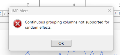

i get this error message when i perform, Gage R&R study. any suggestion to solve this error?

Change the modeling type of the column(s) you are putting in the Group role from Continuous to Nominal

Thank you for your suggestion, it worked out very good
