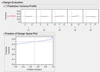

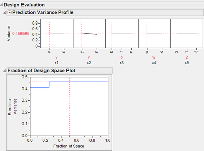

They look very comparable. When I ran the algorithm and giving it 1000 starts under the red triangle my results were lightly different.
I wouldn't lose sleep over either choice.
3802_Screen Shot 2013-06-27 at 11.52.38 AM.png3803_Screen Shot 2013-06-27 at 11.52.57 AM.png

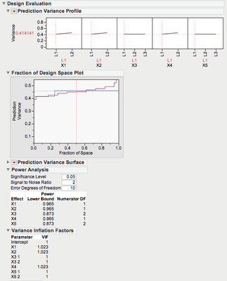

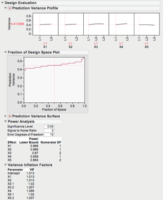

How about a compromise with 2 replicates and 18 runs total? I have attached all three scenarios with the same simulated response model for you to see. Just run the Fit model scripts.
As you can see all approaches are comparable.

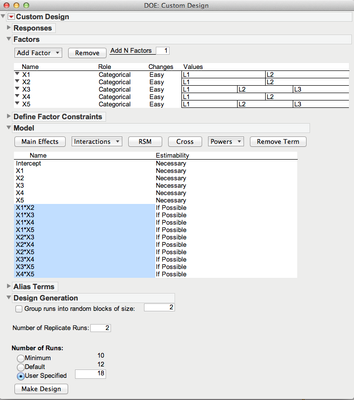

Let me clarify my question. My variables are as following:
I have the possibility of having 18 runs. I could set user specified to 18 or I could change the "Number of Replicate Runs" to 4 which result in 18 runs. Here are the result of both approach:
Specifying 18 in "user specified" field:
change the "Number of Replicate Runs" to 4:
Could you please let me know how to decide based on these results.
Thanks!

Not really. Of the three I prefer the compromise with 2 replicates and 18 runs however quite honestly I'm more concerned that you have not included two-way interactions in the experiment.

Ya, I did not include two-way interactions since it increases the number of runs.

Do you expect interactions from your system? The true power of DOE comes from uncovering interactions which allows you to tune out sensitivities in your system. Since I do not know the context of your problem it is difficult to be much more helpful. Yes the interactions in your model would require more runs and since your factors are all categorical the number of experiments grow quickly. Are any of your categorical factors candidates to be treated in continuous fashion? If so the number of runs can be more manageable.

My experiment is actually designing intersections in driving simulator. each run setting will be an intersection, and each variable is associated with a condition of the intersection (for example variable "pavement condition" with two levels of "wet" and "dry". It is good to have two-way interactions, but as we hire drivers, more number of runs would be expensive.
No, none of my factors could be continuous.

You could always treat the two-way interaction model terms as "if possible" for the same investment of runs.
