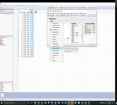

I don't see the process capability platform in my JMP
I have JMP 14.3 not Pro
Please advise
Re: missing process capability in distribution platform
This was a new feature in JMP 15.0.  You will need to upgrade to see this.

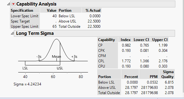

Select "Capability Analysis"
Jim

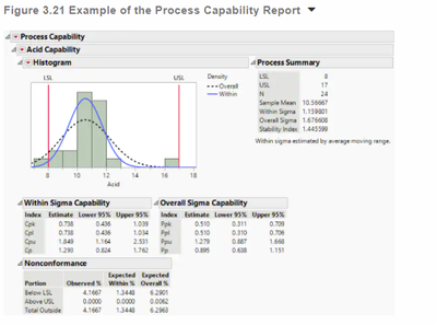

I was looking to get below report but somehow it is not available with that option.
I might be missing to add something in the preferences
