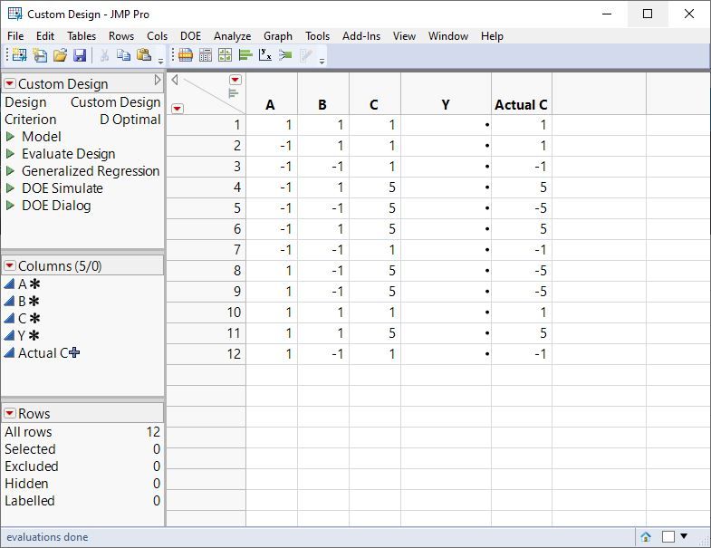

I am not sure that there is anything wrong with using factor C as the ratio (multiplicand) for B. You are building an empirical model, so as long as you think of C as the ratio, and use it as such in model predictions, it should be OK. Here is an example:
You can add a data column after you make the data table to determine the actual level of C to maintain the ratio.
You use C in the model and Actual C in setting up each run. The model could be used to find the optimal A, B, and ratio (C).

Re: DoE with one factor constrained to be in a ratio with another factor
Correct me if I misunderstood your situation or question. I have three continuous factors, A, B, and C. I want to design an experiment, though, for a model for A, B, and the C to B ratio. Here are the factor definitions:
I can choose any linear model, in this case I included interaction terms:
I ask JMP for 16 runs:
The color map on correlations shows that these estimates are orthogonal:
The lack of correlation is a matter of the model and the number of runs, but I can achieve a balanced design in this case to demonstrate that orthogonality can be achieved. Another column must be added to the data table to determine the factor levels for C in each run.
