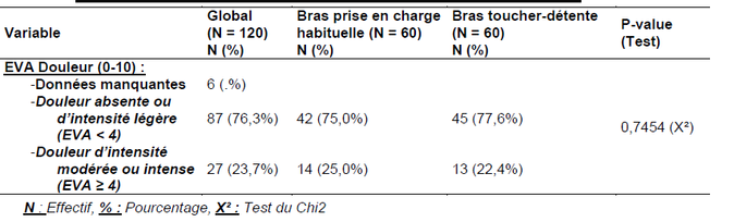

Hello,
I want to make analysis (Chi2 test) but I would make it without missing values.
I don't find the formule in order to doesn't take in account this missing values.
Moreover, I would make a Chi2 to compare the proportion with a EVA pain level ≥4 (cf. variable in yellow) according to the Intervention (salmon color) = 0 between the 2 randomization groups (variable in red).
You will also find my data base in file attach.
Thank you +++
Vocab : "Données manquantes" = missing values ; EVA < 4 (code = 1 for EVA variable (in yellow) ; EVA > 4 code = 1 for EVA variable (in yellow) ; "Bras prise en charge habituelle" --> cf. Bras randomisation (in red) ;
