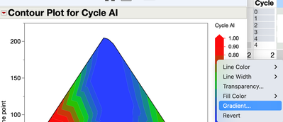

I just upgraded from JMP 15 to 16 on my Mac.  Before, I could change the color theme in a contour plot under the red triangle (I prefer to look at my plots with a spectral theme). I no longer see that option with version 16.  Is there somewhere else I can change the default red to blue to a spectral theme for contour plots?

In the contour plot, try a right click on the legend.
Then click Gradient to pick new ones from there
