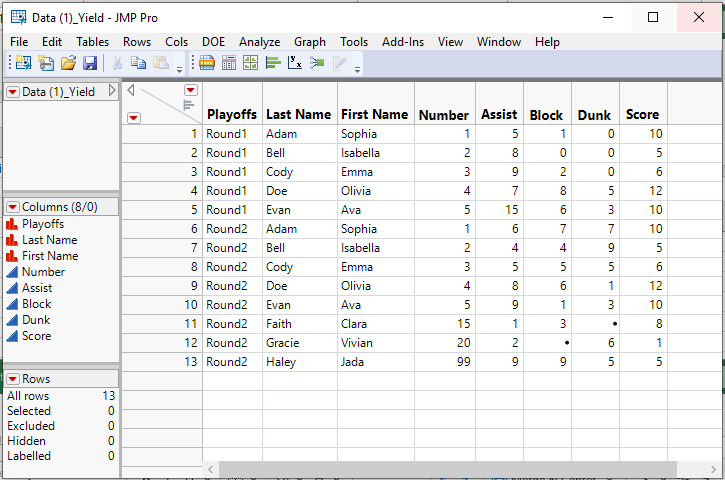

I would set up your data in an analytical form.  Basically, the data are concatenated.  See illustration below:
Jim

The format that I suggest is supported within Graph Builder to produce your suggested graph(s)
Below is a script that produces these graphs from the Concatenated form of the data.  Additionally, if your merged form of the data the
     Tables==>Split
can easily be used to split the data to a row based format
