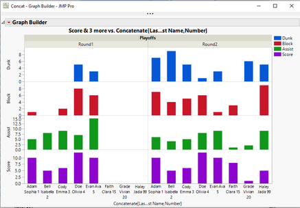

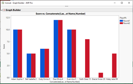

The format that I suggest is supported within Graph Builder to produce your suggested graph(s)
Below is a script that produces these graphs from the Concatenated form of the data.  Additionally, if your merged form of the data the
     Tables==>Split
can easily be used to split the data to a row based format
Names Default to Here(1);
dt = New Table( "Concat",
	Add Rows( 13 ),
	New Column( "Playoffs",
		Character( 8 ),
		"Nominal",
		Set Values(
			{"Round1", "Round1", "Round1", "Round1", "Round1", "Round2", "Round2",
			"Round2", "Round2", "Round2", "Round2", "Round2", "Round2"}
	New Column( "Last Name",
		Character( 8 ),
		"Nominal",
		Set Values(
			{"Adam", "Bell", "Cody", "Doe", "Evan", "Adam", "Bell", "Cody", "Doe",
			"Evan", "Faith", "Gracie", "Haley"}
	New Column( "First Name",
		Character( 8 ),
		"Nominal",
		Set Values(
			{"Sophia", "Isabella", "Emma", "Olivia", "Ava", "Sophia", "Isabella",
			"Emma", "Olivia", "Ava", "Clara", "Vivian", "Jada"}
	New Column( "Number",
		Numeric,
		"Continuous",
		Format( "Best", 12 ),
		Set Values( [1, 2, 3, 4, 5, 1, 2, 3, 4, 5, 15, 20, 99] )
	New Column( "Assist",
		Numeric,
		"Continuous",
		Set Values( [5, 8, 9, 7, 15, 6, 4, 5, 8, 9, 1, 2, 9] )
	New Column( "Block",
		Numeric,
		"Continuous",
		Set Values( [1, 0, 2, 8, 6, 7, 4, 5, 6, 1, 3, ., 9] )
	New Column( "Dunk",
		Numeric,
		"Continuous",
		Set Values( [0, 0, 0, 5, 3, 7, 9, 5, 1, 3, ., 6, 5] )
	New Column( "Score",
		Numeric,
		"Continuous",
		Set Values( [10, 5, 6, 12, 10, 10, 5, 6, 12, 10, 8, 1, 5] )
Graph Builder(
	Size( 739, 450 ),
	Show Control Panel( 0 ),
	Variables(
		X(
			Transform Column(
				"Concatenate[Las...st Name,Number]",
				Character,
				Formula(
					:Last Name || " " || :First Name || " " || Char( :Number )
		Y( :Score ),
		Overlay( :Playoffs )
	Elements( Bar( X, Y, Legend( 11 ) ) )
Graph Builder(
	Size( 739, 500 ),
	Variables(
		X(
			Transform Column(
				Character,
				Formula(
		Y( :Dunk ),
		Y( :Block ),
		Y( :Assist ),
		Y( :Score ),
		Group X( :Playoffs )
	Elements( Position( 1, 1 ), Bar( X, Y, Legend( 15 ) ) ),
	Elements( Position( 1, 2 ), Bar( X, Y, Legend( 14 ) ) ),
	Elements( Position( 1, 3 ), Bar( X, Y, Legend( 12 ) ) ),
	Elements( Position( 1, 4 ), Bar( X, Y, Legend( 11 ) ) )
Jim
