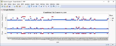

Hi Bill,
i gave the idea of inflating the table rows a go. the result is much closer but their are still a few issues.
now i create a graph in which each row (inflated) is a dot along the axes of row number.
i would like the dots to be in one line for place (in and out). visually this will be a good enough illusion of the sequence i want to see.
another problem is that i can only color by place or by condition but not both separately in the same graph.
attached is the row inflated data table with the script for this output.
thanks!

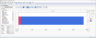

jerry_cooper
Staff (Retired)
Re: making a graph of a sequence
Hi Ron,
I was able to generate the below chart by creating two new formula columns. The first column is a sequence that increases by one each time the Place entry switches I called it Place Group. Then a second column was created using Col Sum for Place Duration with Place Group as the Group By variable. Change the Place Group Modeling Type to Nominal.  Then, in Graph Builder, put the place duration on the X-axis and switch to a bar chart, put Place Group in the overlay zone, and Place in the color zone. Switch the Bar type to stacked and leave Mean as the summary statistic:
This will work for the other two conditions, as well, but, I think you will need to do separate graphs... maybe you can combine them in one window...
I've attached the jmp file with the new columns and Graph Builder scripts. Hope that gets you closer to what you're wanting to do.
-Jerry

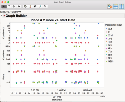

stan_koprowski
Hi Ron,
Here is another option.
I stacked the columns first. I then joined the stacked table back with the original table.
Best,
Stan
Data Table( "graph.jmp" ) << Stack(
columns( :Place, :Condition, :Condition 2 ),
Source Label Column( "Category" ),
Stacked Data Column( "Positional Input" ),
Output Table("stacked")
Data Table( "graph.jmp" ) << Join(
With( Data Table( "stacked" ) ),
Merge Same Name Columns,
By Matching Columns( :start Date = :start Date ),
Drop multiples( 0, 0 ),
Include Nonmatches( 0, 0 ),
Preserve main table order( 1 ),
Output Table( "test" )
Graph Builder(
Size( 693, 562 ),
Show Control Panel( 0 ),
Variables(
X( :start Date ),
Y( :Condition 2 ),
Y( :Condition ),
Y( :Place ),
Color( :Positional Input )
Elements( Position( 1, 1 ), Points( X, Y, Legend( 24 ) ) ),
Elements( Position( 1, 2 ), Points( X, Y, Legend( 25 ) ) ),
Elements( Position( 1, 3 ), Points( X, Y, Legend( 26 ) ) ),
SendToReport(
Dispatch(
"start Date",
ScaleBox,
{Min( 3485228794.98433 ), Max( 3487017600 ), Interval( "Day" ),
Inc( 5.78703703703704 ), Minor Ticks( 1 ), Label Row Nesting( 3 )}
