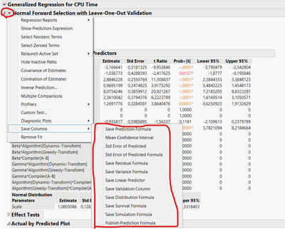

There are easy options you can check first, like when you have done your Elastic Net model, click on the red triangle of the model and go to "Save Columns" : there might be an option here that already solves your question :

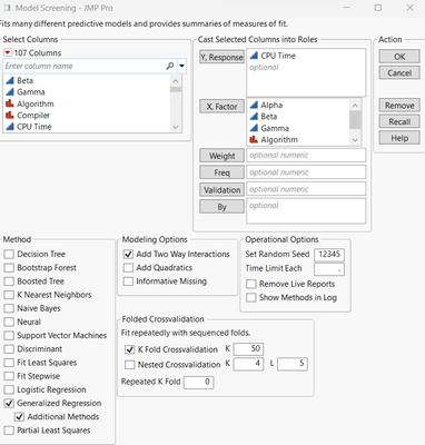

  • If you're interested in individual predictions, you can perhaps try the "Model Screening" platform (in Analyze -> Predictive Modeling), and uncheck all methods except "Generalized Regression" and "Additional Methods" (to have access to Lasso, Elastic Net and Ridge Regression).
    Specify the number of folds equal to your number of observations and run (I have done it here on the "Algorithm Data" dataset from JMP sample index, containing 50 observations):

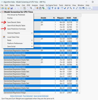

Then, once this is done, you'll have several models constructed with different methods, and you can select the models you're interested in in the "Validation" panel, and click on the red triangle to "Save results table" (to get a summary of each models performances) or directly "Save Prediction Formula" in the original datatable to have all individual predictions with the models :

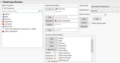

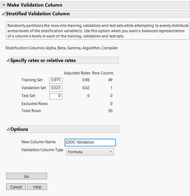

  • An easier option if you're interested in models performance estimation, you can also create simulations with the help of a validation column formula (created in menu : Analyze -> Predictive Modeling -> Make Validation Column). You can create a Validation Column with only one sample in validation set (to have LOOCV), and specify this column as a formula column :
And then use this validation column in the platform Generalized Regression as "Validation" :

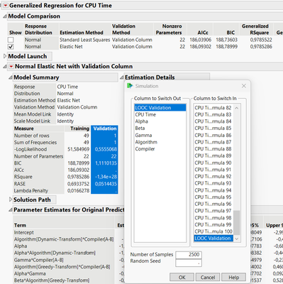

Start your Elastic Net modeling, and then, you can right-click on any results panel to launch a simulation: for example in Model Summary, right-click on column Validation, then "Simulate", and specify you want to switch in and out the validation column formula, to vary the validation point.
You'll get a new table with the model results of simulated samples from the validation formula column.

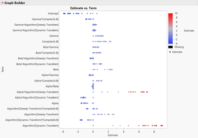

You can also do this on Parameter Estimates, to see if the values for the coefficient remains stable or not with various validation points :
