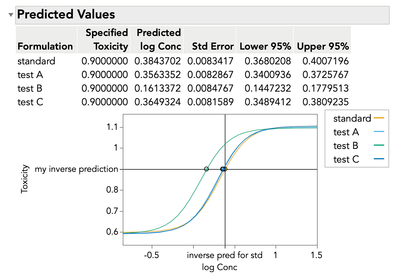

For a set of graphs, I draw a reference line on the y-axis. I want to compute what the x-axis values are at points where the reference line intersects the various curves/graphs. I have attached an image of the graph. Is there any way that I can compute these x-axis values using a script or any other way?

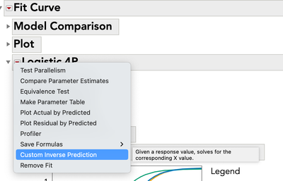

Go to this menu:  Analyze>Specialized Modeling>Fit Curve.
Put in your X, Y and Group variables.
Try fitting Sigmoidal Curve, 4p Logistic, or a model like that.
After you fit the model, look under the red triangle menu for the fit to find inverse prediction:
Here's an example using the sample data of what it will look like:
Note: I added the reference line annotations, those don't happen automatically .

		Dispatch(
			{"Logistic 4P", "Inverse Prediction", "Predicted Values"},
			"1",
			ScaleBox,
			{Add Ref Line( 0.3843702, "Solid", "Black", "inverse pred for std", 1 )}
		Dispatch(
			"2",
			ScaleBox,
			{Add Ref Line( 0.9, "Solid", "Black", "my inverse prediction", 1 )}
