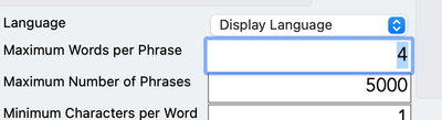

Is there a way to show one row for the phrase "Write error:status 1, facility 667,driverstatus 1304" and not decomposing it ?

in the launch dialog, you can increase the number of words per phrase. The Default is 4.

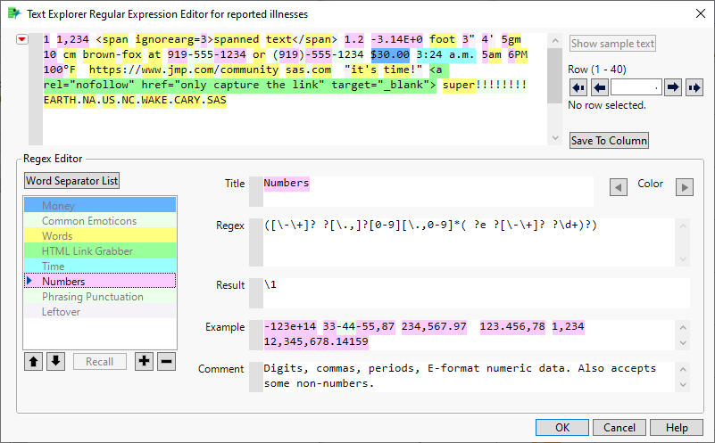

You can create a new regular expression using the Regex Editor in Text Explorer to recognize this pattern and return a new token in its place. Make sure that it appears ahead of the regex for Numbers.
You can change the Result token for the Numbers regular expression to empty with the Regex Editor.

I am not familiar at all with Regex Editor. How do I access it and how to use it ? Is there any related documentation ?
I don't get your point about changing the result token for the Numbers. What should I do exactly ?
Thanks
Re: Text analysis : need help to deal with phrases
The Regex Editor in Text Explorer is documented.
Here is an example of a text analysis using the default set of regular expressions:
See the Result field? It uses the "\1" back reference to output the result to the token list. Clear this field so that numbers are not entered into the token stream.
