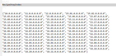

I previously created this list, how can I swap this RecipeStepIndex into the Y groups
//Build and prefill an Array of names of the RecipeStepId
Summarize( dt, RecipeStepIndex = by( :RecipeStepId) );//get list of unique RecipeStepID's
