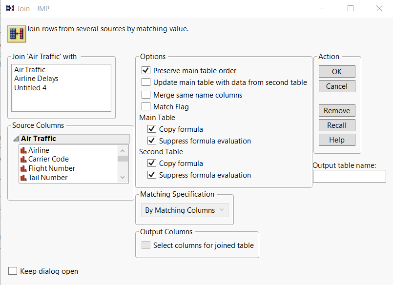

When you open a data table in JMP, navigate to Tables > Join , when you click on the Join you will see the following screen - this enables you to chose the tables with which you want to perform the join and also allows you to select columns for the joined table.

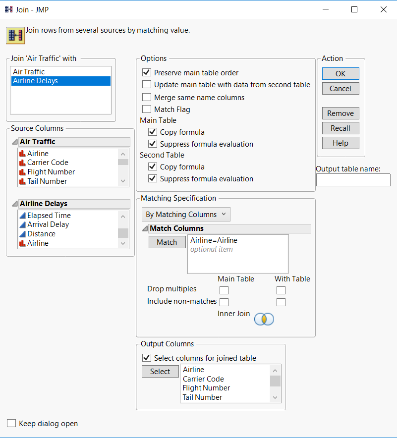

        Please look at my previous response. If you were to select interactively , at the end of the Join Platfrom there is an option that allows you to select columns from both tables during the join. The same concept applies if you were scripting.

Which you are able to do - in your screenshot. So your problem is solved.
While my example does not demonstrate selection from "Airline Delays" as long as you are able to do it- I am not sure what other problems you are running into ?
