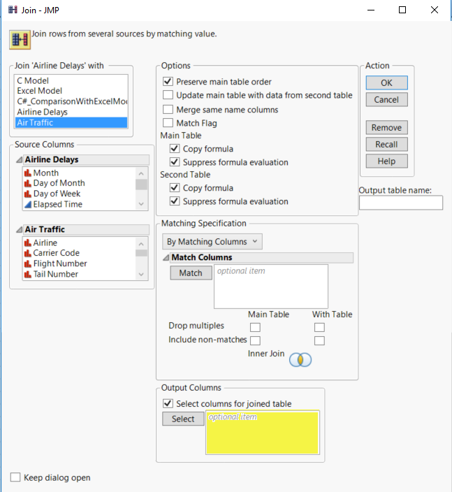

When you open a data table in JMP, navigate to Tables > Join , when you click on the Join you will see the following screen - this enables you to chose the tables with which you want to perform the join and also allows you to select columns for the joined table.
![image.png image.png](https://community.jmp.com/t5/image/serverpage/image-id/9395iCB3AC04AAB2F2766/image-size/large?v=v2&px=999)
![image.png image.png](https://community.jmp.com/t5/image/serverpage/image-id/9396iA4702E8779B0ED14/image-size/large?v=v2&px=999)
