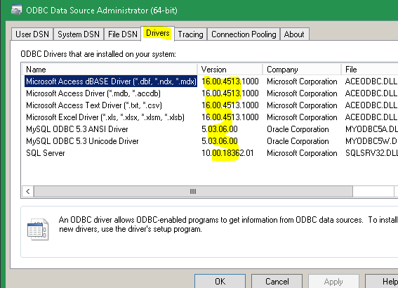

Re: jmp crash report for diagnostics
Start with the ODBC drivers perhaps
start menu, type data source...start menu, type data source...
Drivers tabDrivers tab
Maybe it will be an older version that has issues. Tech support will want to know the versions too.
Craige

@Craige_Hales thanks, you're Right I will have to tell which Driver is used.
But I don't think that this is the issue, because:
  • generally the Driver works
  • we all have the same Driver, installed by IT as System DSN (so nobody can Change on his own)
  • only some People have These problems
My current Problem is how to gain additional Information regarding this issue. So I ask People having this Problem to tell me under what circumstances the crash occurs, but so far have no substantial answer.
One possibility is, that JMP crashes silently when using a script that starts two Background queries in parallell and waits for finishing of both. The Problem is, that JMP Ends without any trace why (that I could see).
