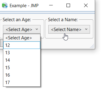

I'm trying to automate my everyday task. I want the following script to run periodically and save the output.
Can JMP auto select from the drop down list and save the output?
For ex. Selecting a Age then selecting a Name and then saving the output for all the age from 12 - 17

Your question(s) are confusing. You ask about automating "the following script", but there is not a script, unless your picture of the display boxes is referring to the script behind the display boxes. On the automation, yes, you can use the Schedule() function to wait for a specific period of time and the run a script.
Concerning the pull down menu selection, it would be my assumption that JSL can query the lists that create the pull downs and from that get the information needed. But it would not be making the clicks, etc. in an automated script.
JSL is a very complete programming language, so you can pretty much make it do whatever you want.

In JMP, the pull down boxes you displayed are called Combo Boxes.  Below is an example taken directly from the Scripting Index that illustrates what message to pass to  the Combo box for it to return to the script, what items are in the Combo Boxcombo.PNG
Names Default To Here( 1 );
New Window( "Example",
	cb = Combo Box(
		{"One", "Two", "Three"},
		selection = cb << GetSelected();
		Print( "Selected: " || selection );
Print( cb << Get Items );
Jim
