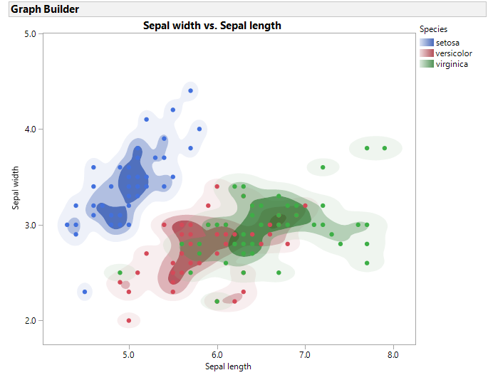

Maureen, I believe Cameron answered your question. If you open teh JMP sample data table Iris.jmp, there is a GraphBuilder Contour plot script that produces this graph
Below is and example of sample data LittlePond.jmp's contour plot with an added column called Sea leve, that is "Below" when z < 0 and "Above" when z >=0.
