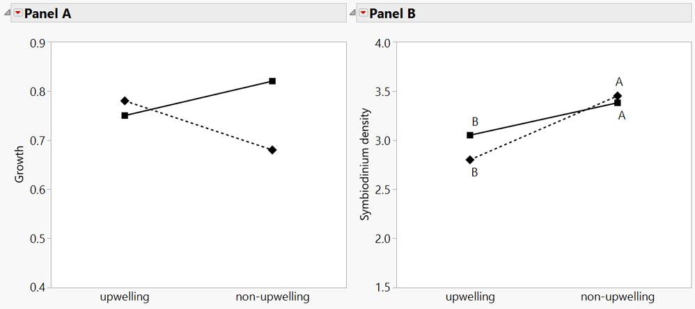

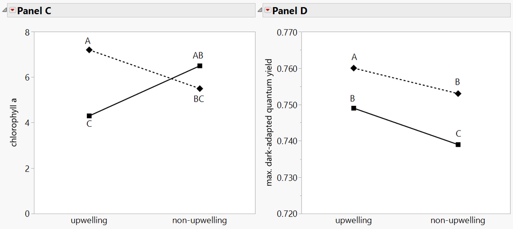

Something I neglected earlier is adding labels to individual points by selecting the rows you want labeled and going to Rows > Label/Unlabel.  This should enable you to do what you want in this graph.  I basically recreated your example (except without the error bars), but I had to journal the plots 1 at a time because I needed to change the labels for each panel.
Here's what the final result looks like:TopPanels.PNGTopPanels.PNG
I'm attaching the journal file, but there's a frustrating bug where the custom line settings get messed up after saving and re-opening the journal.  You'll probably notice all the lines will be dashed when you open it.

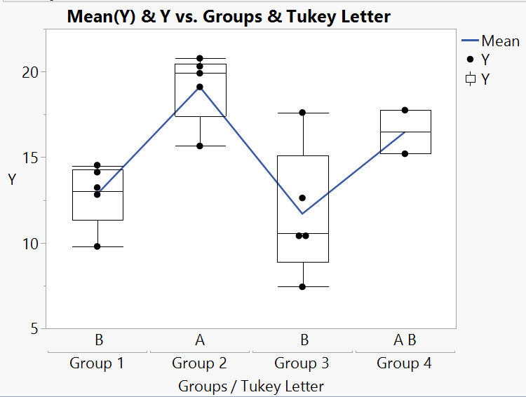

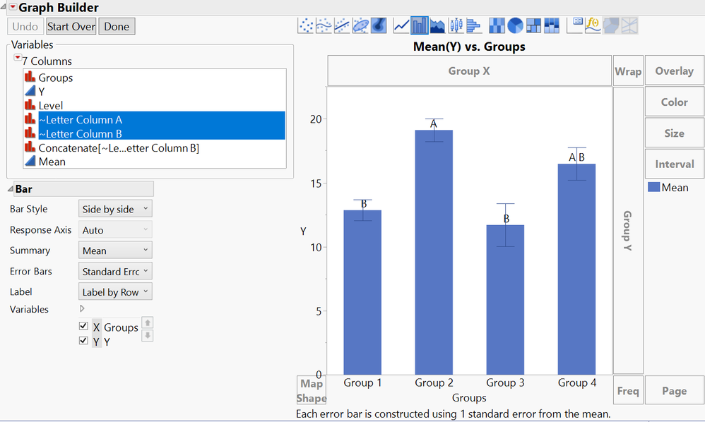

I think this is possible without too much work and no scripting.  The basic idea is to create a data table from your Tukey connecting letters report and join those letters to your original data matching the group name to the Levels column from the Tukey table.  Then, combine the columns with the letter groups by selecting them > right-click on any of the highlighted columns > New Formula Column > Concatenate (with Space or with Comma).  Next, select the resulting column and use it for labels (Cols > Label/Unlabel).
Finally, make your plot in Graph Builder.  After I made a bar chart, I was able to add error bars and labels as you showed using the Control Panel controls for Bar.GBTukeyLabels.PNGGBTukeyLabels.PNG
 **Community is not allowing me to post the table ("The contents of the attachment doesn't match its file type").  Here's the script to reproduce it:

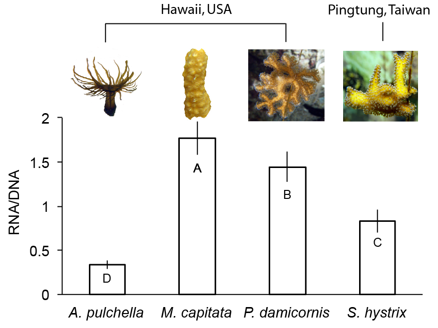

Could you upload a picture of what the plot you're envisioning might look like?  I'm sure there's some way to twist JMP's arm into making it.
-- Cameron Willden
abmayfield
Level VI
Re: adding post-hoc groups to plots
Mayfield et al. JEB Fig. 2.pngMayfield et al. JEB Fig. 2.pngI want to have something like this: one treatment on the x axis (upwelling vs. non-upwelling), then the icons represent two different temperature regimes. In panel c, you can see interactions between the two predictor variables, but not in D. In panels b-d, I included letters to show post hoc differences. I wonder if I could make such a figure in JMP?
Anderson B. Mayfield
Data table script (again, cannot attach data table directly):

abmayfield
Level VI
Excellent! I never even thought to use the row and column labels, but it appears that they can be used with line graphs.
I may best a "need" for JMP develops that is an extension of this: When you use Graph Builder, you can have it plot summary statistics, such as mean and error bars. If there was another option below error bars for post-hoc group labels that would be awesome! But then again, it's not a big deal to copy and paste the means, std. devs., and post-hoc groups into another table and then use Graph Builder to plot out the summary data (rather than the raw data). Thanks again and hope this is useful to others.
